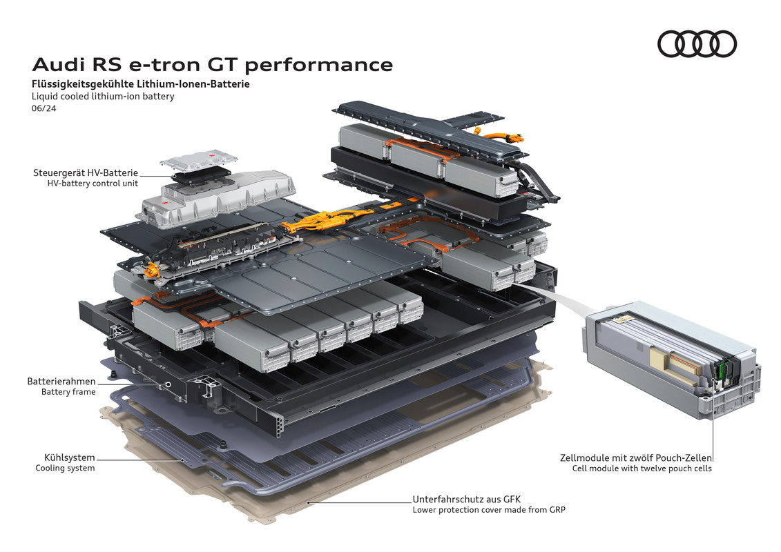

Lighter battery with higher energy density, range up to 609 km**
Audi has lowered the weight of the high-voltage (HV) battery while simultaneously increasing its energy density. Despite the higher energy content, the weight of the HV battery has been reduced by nine kilograms to a total of 625 kilograms. The HV battery boasts a gross storage capacity of 105 kWh (net: 97 kWh). Among other measures, optimizing the two-layer cooling plate results in a twelve percent increase in capacity for the 33 cell modules, each holding twelve pouch cells with a flexible outer skin. Audi has also modified the cooling system of the cells themselves.
This measure, combined with changes in materials and separators and adapted cell chemistry, results in a higher cell energy density. The energy available to the new e-tron GT family via recuperation (regenerative braking) has also increased from 290 to 400 kW. The driver can select manual or automatic recuperation via the MMI as well as control it in three levels using the shift paddles.
Audi has further increased the maximum charge and discharge currents to 400 amps through an increased current flow inside the individual cells. The changed cell chemistry and the further optimized, intelligent, predictive thermal management system with improved pump and valve switching and refined preconditioning allow more power to flow during charging. The newly designed charging system of the combined booster converter also contributes to an improved charging performance by reducing the weight by 2.3 kilograms and providing the voltage conversion stages from the battery to the final load.

Não fazia ideia que estavam a usar as pouch cells!
